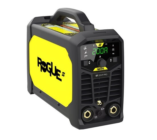

Rogue ET 201iP Pro is a powerful high frequency start TIG machine. This easy to use welder is designed with a robust and durable housing that is IP23S rated. Weighing only 9.6 kg (21.2 lbs) this lightweight welder features an ergonomic handle, carrying strap and long extension cables for maximum portability.
Rogue ET offers exceptional arc characteristics, both in TIG and Stick mode. Want more control over your welder? Rogue ET provides several TIG parameters that can be easily adjusted including gas pre flow, start current, ramp up time, ramp down time, finish current and post flow. All of which can be programmed using 2 or 4 stroke mode for greater arc control. Additionally, Rogue ET 201iP PRO offers a pulse feature with background current control and frequency adjustments up to 500 Hz for better heat input control. In Stick mode, Hot Start or Arc Force can be adjusted according to individual welding preferences or applications.
New Pulse SMAW functionality enhances Rogue's performance and improves the heat input control, to minimize thin gauge materials distortion , facilitate out-of-position welding with no undercuts and reduces spatter, thus helping to effectively avoid a number of welding defects.
