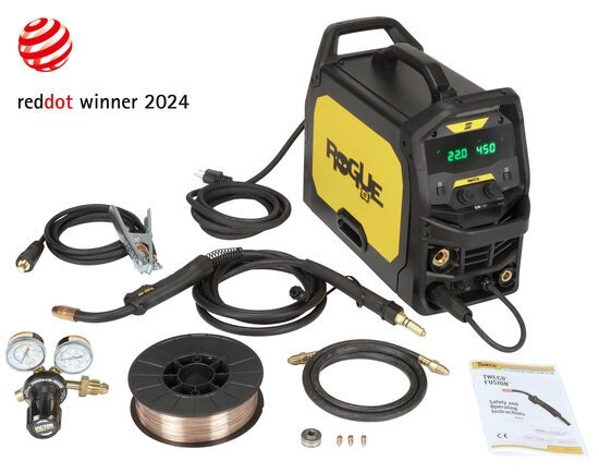

ESAB Rogue EM 140 is an inverter-based MIG/MAG welding system designed to address all your welding project needs, from light fabrication to repair and maintenance. The system features industrial-grade arc performance and full featured controls that allow the welder to fine tune arc characteristics based on the material they are welding.With a weight of only 13 kg (28.8 lbs), single voltage 120V single-phase input and compatibility with 6 kVA (4.8kW) generators, this system provides maximum flexibility and portability, both in the shop and in the field.

Rogue EM takes single-phase welders to the next level with MIG/MAG and Flux-cored welding, proven Rogue performance and a rugged industrial design. Break away from convention with Rogue and upgrade the capabilities of your shop.
A Portable Workhorse.
Rogue’s compact and lightweight design makes it easy to carry from job to job, with sturdy handles and a small footprint. Thanks to stable arc performance, performs in the workshop or on-site, on both mains and generator power, all without affecting weld quality. With its durable and weather-resistant housing and IP23S rating, Rogue is the definition of a portable workhorse.
Built to Withstand Impact After Impact.
No other machine at this price point comes close to matching Rogue’s strength. Its robust and rigid fiberglass-molded housing is built to withstand impact after impact, in the shop or in the field. Like every ESAB machine, Rogue comes with our industry-leading, 3-year warranty for unbeatable peace of mind. Goodbye cheaply constructed welders, hello strength and toughness when you go Rogue.
Premium Features Without The Premium Price.
With Arc Dynamics you can fine tune arc characteristics based on the material you are welding. So if you need a stiff arc for carbon steel, or a soft arc for stainless, Rogue does not back down. Advanced MIG features include adjustable pre- and post-flow, burn back control, wire jog and gas purge.
