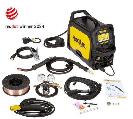

ESAB Rogue EMP 210 PRO is an inverter-based multiprocess welding system designed to address all your welding project needs, from light fabrication to repair and maintenance. The system features industrial-grade arc performance and full featured controls that allow the welder to fine tune arc characteristics based on the material they are welding.
  Best Offer
Starting at:
$1,746.03 + Freight
Enter a valid postcode
+ Details
With a weight of only 16.9 kg (37.3 lbs), dual voltage 120/230V single-phase input and compatibility with 11 kVA (10 kW) generators, this system provides maximum flexibility and portability, both in the shop and in the field.
