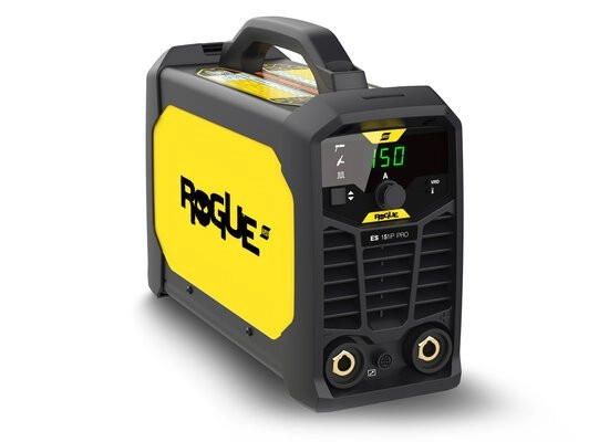

The Rogue ES is a robust and durable power source for the professional welder. The machine provides state-of-the-art welding performance and reliability through use of the latest high performance power electronics and digital control; ensuring a precise consistent arc.
Choose the Model:
ES 151IP PRO ES 201IP PRO
  Best Offer
Starting at:
$695.08 + Freight
Enter a valid postcode
+ Details
The Rogue ES provides smooth DC (Direct Current) welding power which allows you to weld a variety of metals, such as alloyed and non alloyed steel, stainless steel, and cast iron. Featuring Arc Force and Hot Start settings for more control over your arc. Digital microprocessor offers more control over all arc parameters and provides best-in-class welding performance. The Rogue ES 201iP PRO weld electrodes up to 4.0 mm (5/32 in.) and Rogue ES 151iP PRO weld 3.2 mm (1/8 in.) electrodes.
New Pulse SMAW functionality enhances Rogue's performance and improves the heat input control, to minimize thin gauge materials distortion , facilitate out-of-position welding with no undercuts and reducing spatter, thus helping to effectively avoid a number of welding defects.
Rogue ES can TIG weld mild-steel or stainless steel via "LIVE TIG" functionality (TIG torch sold separately) for even more versatility.
Highlights
  • Dual voltage input power – flexibility to use on either 120V or 230V outlets
  • Pulse SMAW functionality - improves heat input control, minimizes distortion of thin materials and helps reduce spatter for higher quality welds
  • Superior Arc characteristics – smooth and stable performance (including special mode for stick 6010)
  • Generator Compliant – suitable for use with generators. (7kW recommended)
  • Easy to Use – and adjust a wide range of arc parameters for more control over your weld
  • Superior Portability - lightweight welder with carrying handle for easier transport on the jobsite, garage or in the shop
  • Robust Design – IP23S designed for fabrication shop or site application
  • PFC ensures a stable arc, resistant to power fluctuations even while working on long extension cables up to 300 feet (12 AWG size)
  • Optional analogue remote control (Remote sold separately MMA 4)
Break the Rules. Go Rogue.
Rogue breaks all the rules, giving entry-level welders premium accessories and everything you need to start welding, right out of the box. In fact, Rogue’s power stacks up against machines twice its price. Rogue’s new MMA Pulse functionality provides users with improved control, enhanced penetration, reduced spatter, and increased welding speed. Power Factor Control (PFC) technology allows for a highly efficient and steady arc that is resistant to power fluctuations. Break away from convention with Rogue.
More Control with MMA Pulse.
Rogue’s Pulse feature provides welders with enhanced control over heat input and arc stability. The controlled pulsing action helps create a stable arc, preventing excessive spatter and minimizing the risk of weld defects or the need for post-weld cleanup. Rogue’s Pulse waveform facilitates better penetration and fusion in the welding process, which is crucial for creating strong, durable weld joints and ensuring the structural integrity of fabricated components. Pulse technology helps in minimizing the heat-affected zone, reducing the likelihood of material distortion or unforeseen metallurgical changes.
A Portable Workhorse.
No matter where you are working, Rogue is easy to use. Rogue’s compact and lightweight design makes it easy to carry from job to job with sturdy handles and a shoulder strap. It comes with a large digital display that can be easily read from up to 25 meters away, and the optional remote control even allows you to adjust current settings without going back to the machine. Thanks to stable arc performance and weather-resistant housing, you can use long extension cables to work in even the most remote locations, all without affecting process stability and weld quality.
Pulse with Impact.
Pulse MMA and TIG welding are versatile techniques suitable for a wide range of materials, including stainless steel, carbon steel, as well as non-ferrous metals’ alloys. This versatility makes these welding methods suitable for diverse industries, from automotive manufacturing to aerospace, providing welders with flexibility. The benefits to using Rogue’s new MMA Pulse functionality extend across applications, providing easier gap bridging and better penetration in root pass processes causing stronger welds. This reduces undercut in vertical welding, provides better weld puddle control in overhead welding to better keep material in place, and reduces burnthrough and material distortion with thin gauge materials.
