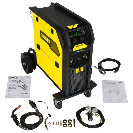

Rustler EM 280 PRO MIG/MAG compact welding inverter is your solution of choice for the most common challenges welders face across all industries. Equipped with the latest inverter technology offering the advantage of low energy consumption on 208 VAC or 230 VAC single phase power with optimized weld performance.
  Best Offer
Starting at:
$3,408.90 + Freight
Enter a valid postcode
+ Details
Rustler is ready to weld most common base materials with optimized welding programs for carbon steel, stainless steel, aluminum, silicon bronze, and flux-cored wires. Smooth wire feeding is delivered by a reliable and well proven 4-wheel industrial drive mechanism.
The durable housing is enhanced with an optional flexible accessories storage system, allowing users to store and protect additional tools as needed. Additional features include inspection window, LED light in spool compartment, torch holder and cable management for an efficient and comfortable working environment.
Highlights
  • High output current and duty cycle for increased productivity, including superb arc characteristics optimized for most common base materials benefiting less rework
  • Welds up to 13 mm (1/2 in.) steel and 9.5 mm (3/8 in.) aluminum
  • Digital display for easy and intuitive set up and adjustments and a feature rich user interface with trigger control, arc dynamics and many more adjustments
  • Energy Save Mode – after 2 minutes of inactivity the unit will enter this state to reduce power consumption
  • Spool gun ready allows for quick set up of spool gun for smooth Aluminum welding (spool gun sold separately)
  • IP21 rated for indoor use
Additional Information
  • Input Voltage:
    • 208 V ±15 %
    • 230 V ±15 %
  • Current Range:
    • 30-280 A
  • Voltage Range:
    • 12-30 V
  • Energy Save Mode: < 30 W
  • Operating Temp: -10 - +40 °C ( +14 - +104 °F )
  • Rated kVA: 9.78 kVA
  • Duty Cycle:
    280 A28 V @ 25 % Duty Cycle
    162 A22.1 V @ 60 % Duty Cycle
    125 A20.25 V @ 100 % Duty Cycle
    198 A23.9 V @ 40 % Duty Cycle
  • Enclosure Class: IP21
  • Certification Mark:
    • cETLus
  • Open Circuit Voltage: 68 VDC
  • Wire Feed Speed: 2-17.8 m/min ( 80-700 in./min )
