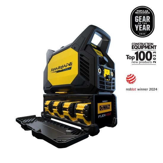

ESAB Renegade VOLT™ ES 200i is a portable, cordless battery powered, Stick (SMAW) and Live TIG (GTAW) welder with the versatility to operate in Battery, Mains, or AMP+ Hybrid Mode.
This cordless welder runs on 6 Ah, 9 Ah, and 12 Ah DEWALT® FLEXVOLT® batteries. Renegade VOLT provides the power to burn up to 33 (E6013) electrodes on a single charge using four 12 Ah batteries, that are included in the package.
  Best Offer
Starting at:
$3,958.90 + Freight
Enter a valid postcode
+ Details
This cordless welder runs on 6 Ah, 9 Ah, and 12 Ah DEWALT® FLEXVOLT® batteries. Renegade VOLT provides the power to burn up to 33 (E6013) electrodes on a single charge using four 12 Ah batteries, that are included in the package.*
Renegade VOLT is a highly portable and powerful unit perfect for mobile welders operating in remote, offsite, or hard-to-reach locations without easy access to AC mains power.
In AMP+ Hybrid Mode, Renegade VOLT supplements AC mains power with battery power to prevent nuisance trips on smaller breaker sizes (e.g., 10A, 16A) or to provide more output when welding on 120V input.
Renegade VOLT features a rugged industrial design with durable, impact-resistant housing and multiple lift points for easy operation and transport in the field. The bright, intuitive color-screen user interface is designed for outdoor use, even in direct sunlight, and features a battery status display and remaining arc time calculator.
This powerful welder offers the highest arc quality with special features that include hot start, arc force, memory storage, and cellulosic mode (6010) to optimize performance based on application or user preference.
*based on standard operating conditions
