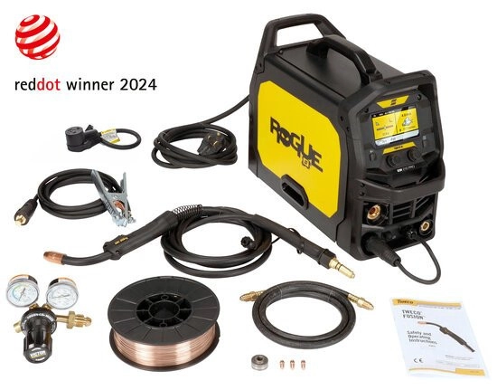

  • ESAB EM 210 is a MIG/Flux Cored welding system with a 30-200A output; welds material from 22 gauge up to 3/8 in. in a single pass; accepts 4 and 8 in. diameter wire spools
  • ESAB EMP 210 is a Multi-Process MIG/Flux Cored/Stick/Lift TIG welding system with a 10-200A output. Stable Lift TIG arc at low amperage for total control; power to run stick electrodes up to 5/32 in. Digital controls with large easy-to-read LED display enable fast, easy and more accurate operation
  • Improve welding results with advanced functions typically found on industrial machines: MIG wire run-in, burn-back, variable inductance, 2T/4T trigger control, Lift TIG arc starts, gas pre and post-flow, Stick hot start and arc force control
  • Portability and flexibility to weld in a variety of locations. Both units weigh just under 29 Ibs each, connect to 120/230V primary power, and are compatible with 10 kVa generators
Advanced Functionality for Superior Welding Results
These industrial machines feature advanced functions to deliver superior welding, including MIG wire run-in, burn-back, variable inductance, 2T/4T trigger control, Lift TIG arc starting and more.
The Ultimate Welding Package
EM 210 and EMP 210 welding machines come with a full range of genuine Tweco & Victor accessories including a Tweco 17V TIG torch and Tweco electrode holder to create a complete welding package. Both systems are spool gun ready for MIG welding aluminum with the optional spool gun, while EMP 210 is compatible with an optional remote foot control for TIG welding.
Unmatched Portability and Flexibility
Weighing just under 29 lbs, these portable welders easily connect to 120/230V primary power and are compatible with 10 kVa generators making them perfect for outdoor welding applications.
